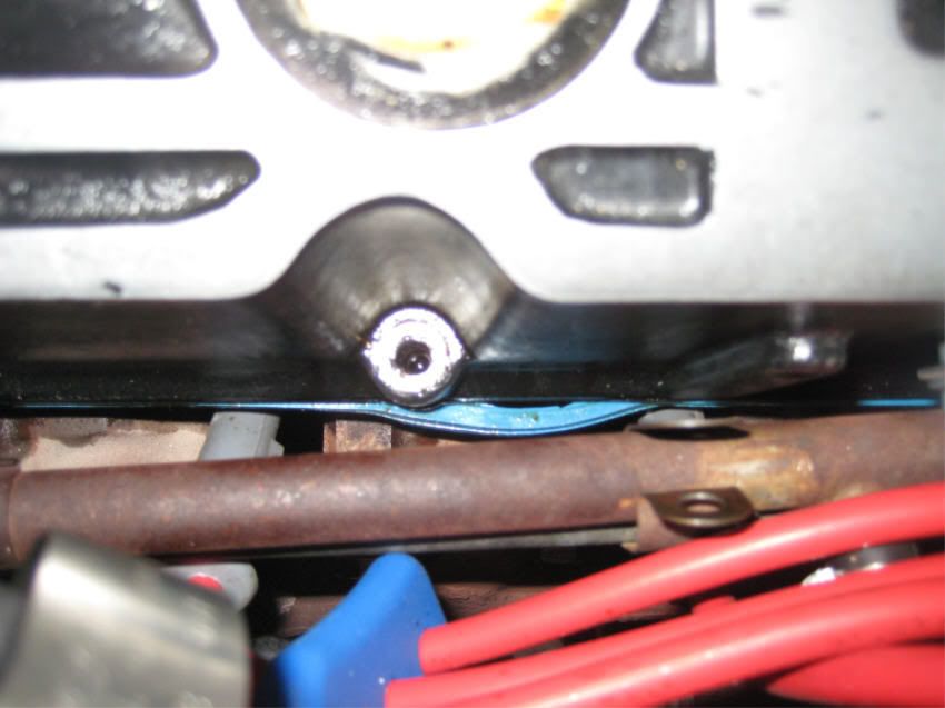

Aye so I followed advice and picked up a Ranger 2.3 VC gasket, and even checked the part numbers for:
Ranger 2.3, TbirdTcoupe, Must SVO, and 87 XR (mine).. all the same part numbers. They listed 1 cork gasket and 1 blue "premium" Felpro VC gasket for all 4 cars, so.. I got the premium, thats what was on there before in fact.
Get it home, unbox it.. remove VC.. looks exactly the same BUT...
stupid new one seems 2mm or so too long length wise AND over the front of the head/cam tower#1...
In fact.. so much that it "wrinkles along the side a tad (both) AND was next to impossible to keep in place under the VC at the front.. had to hold it in and clamp it down.. 2 weeks later.. stupid thing slips out from under the VC about half way back on the Exhaust side and smokes oil onto the EM...
Grr.
Anyone know why its 2mm 1.5mm?!... too long... did I get a defective one? The "one to use" IS the 92 Ranger (or so) Blue silicon looking w/wire ring one right?
I really dont want to even try the cork one.. I hate cork.

Don't know the part #, but know it's listen in the Merkur tech. or Merk. Encyclopedia somewhere. The Fel-Pro is junk because it doesn't have the steel retainer built in. The Ford part is the only way to go.

Obviously you didn't read.
Get the FORD Ranger gasket from a FORD dealer....
Simple enough.
As I mentioned in the thread Brad posted...
Simple enough.
Go to a Ford dealer and get this gasket...
F57Z-6584-A
The last valve cover gasket you will ever need.....

What glue are you using?
Is the gasket still reusable after that?
I've been isntalling my motocraft dry myself...wiping off all the oil then using a little brake clean on a towel to clean both gasket surfaces to keep the gasket from slipping...

For the XR I use a very thin bead of blue or black silicone on the head side only. I put a thin coat of oil on the VC side of the gasket before putting it on. This keeps the gasket from slipping when I put it on. I've had the VC off several times and no leaks.
On the Scorpio I use silicone on the VC side. I use some clips to hold it in place while the silicone cures. Scorpios are worse for leaks than XR's. The gaskets never quite fit right.

Ok fine Brad I see now lol...
Listen closely!!
I was WRONG!! HA!
Turns out I did read that very thread when my problems came about.. and was smart enough to write down the part number (which I ordered from FLM this morning and will be in tom morning so I can get to racing)

So heres how it failed.. I suspect this is very common.
Popped out the side...
And trying hard to slip out the front cam tower too...
