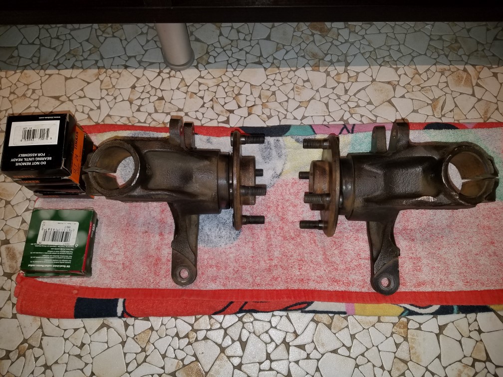

Found the spares... gonna see if I can con someone into putting new bearings in them this afternoon. Decided I'd rather agonize over my brake booster check valve than wheel bearings... really for no good reason.
I'll replace the studs with ARP parts from mc2 before installing. No joke, I've had the studs and the bearings in a box for ten years. I suck.

Got the knuckles back from the shop - they kinda hosed me with a whole "it was really hard" sob story and a $150 bill, but it was still cheaper and faster than me buying tools, so whatever. It's done...
... Only thing is, the hubs feel *really* tight. The tech said he only put 195 lb ft on the nuts because spec (215 lb ft) didn't feel right to him.
They are actually difficult to turn by hand. I'm not sure if this is normal, perhaps his torque wrench was miscalibrated? I'm hesitant to retorque them. Anyone have any opinions on what "normal new tight" should feel like?
