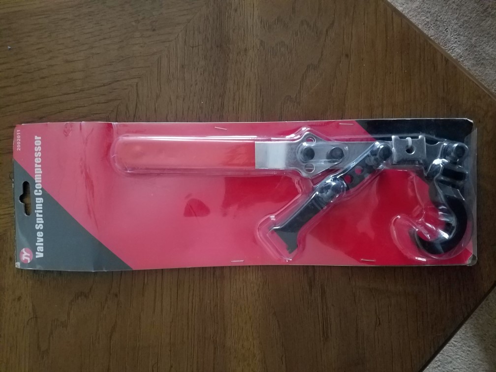

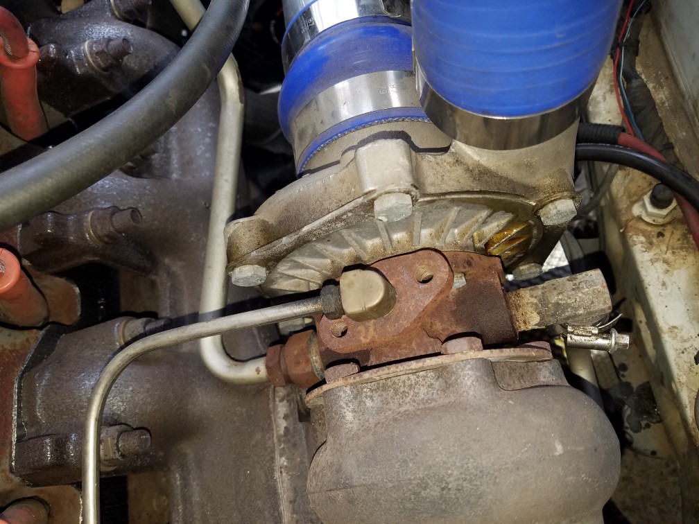

Got the email yesterday morning that my imposter KD tool had arrived, and got even more excited on my way home as the oil smell was getting pretty bad. Maybe too bad. Like, not valve stem seals but active external oil leak.
Oh yeah, there it is. CHRA leaking to the outside is a new one for me, but it's what I've got and it's pretty severe now.
Not exactly sure what my move is... I've never particularly cared for this turbo as it's simply too large, but it seems like there's a weird gap in the T3-based turbos between 250hp (where a T3-Super60 fits) and 350hp (where you have the hybrid T3/T4, like mine). I'm not interested in switching families, I want to keep this bolt in, so T3 4-bolt in, T3 5-bolt out, and a 2.75" (IIRC) inlet. I'm hoping I can find the original order for this turbo and there's a smaller trim that'd be a good fit.
I think I will also replace the oil feed line with AN plumbing. I found the factory oil line really gets in the way of any useful heat shielding, so now's my chance.

FWIW, the imposter tool looks solid:
Mixed feelings about cheap but difficult valve stem seal replacement vs. easy but expensive turbo replacement.

.... but, uh, it's now quite obvious what was happening here:
http://forum.merkurclub.com/forum/viewt ... 30&t=32524
when my turbo went ppooooooooooooooooft. Since it only goes a few hundred miles a month generally I think it was just slow-motion turbo failure.
