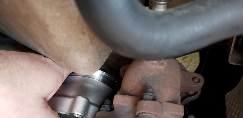

I reached out to ATP to see if this:
could be made available without the flex section. It *might* clear with their "ultimate adapter." The adapter is 2.5" and this piece is 4.5" deep and there is JUST 7" between the turbo and the firewall. If any measurement is off just a smidge in a favorable way... :)
I am interested in using that elbow sans flex pipe on my SPG, so I have a reason to buy. With both in hand I can take those measurements and see what's what. Alternatively I could buy with flex pipe and then hack it off to use on the SPG if it wouldn't work on the XR, but it seems dumb to pay Big Dollars for a flex pipe I'm gonna trash, so I'll wait & see what ATP has to say. ;)
