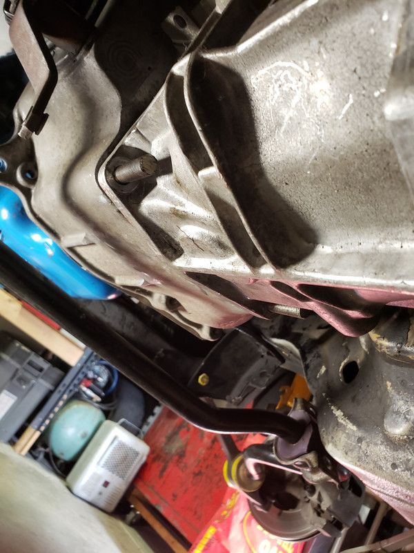

Got the trans itself installed to day:
I used the all thread in the bottom holes to get things started after the input shaft was started. Then used 2 bolts in top holes to draw it up the rest of the way. Finger tight first to ensure most of threads in the AL bell housing so wouldn't strip em. In the future I think I will do this the way I did the automatics, which is with the bell on the trans. I just don't have the strength anymore to push 85 pounds around and line up the front over on the trans jack.

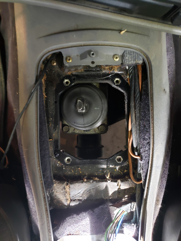

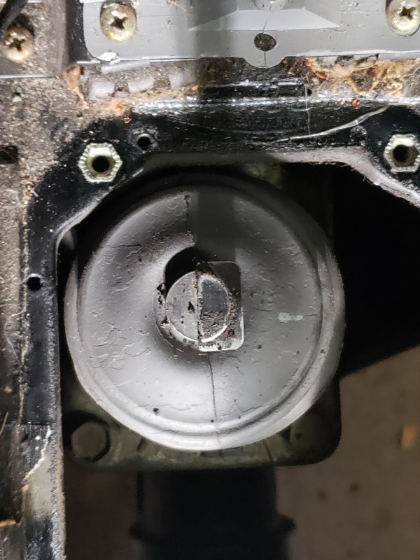

I don't think I'm gonna have to cut sheet metal here. My car is an early 86 I think. I have to look at my build date again, but it's like Feb 86. Anyhow Ghost said he removed a piece that was riveted at the front of the hole, and mine is already at the back from the factory, so I don't think I gotta do anything to enlarge the hole here. Will check again when I get the rest of the trans mount bolts tight, and line up the driveshaft. If I ever have to have the trans out again I might spend the money to get the Camarobird tailshaft, and housing this is really far forward, more than I expected it to be. But I guess that's what angled shift handles are for :lol: I'm using the stock C3 trans mount turned around 180°, and the little adapter that Ghost made when this trans was in his car.

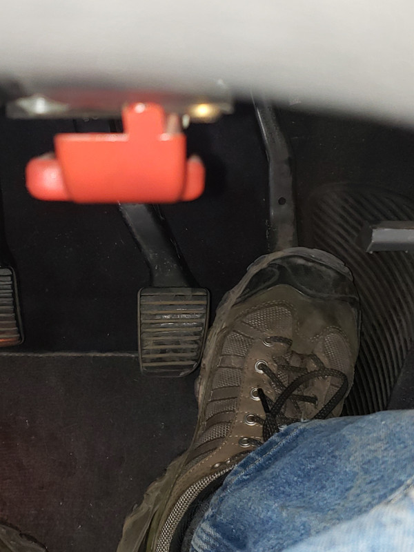

Wow, my brake pedal is high, like a whole inch plus above the gas, and my tiny 7 and half foot is so big that I won't need to worry about heel toe :roll: :lol: I did take a brake pedal and clutch pedal from a manual XR, I think it was an 85. I did not reuse the sheet metal piece that wraps around the clutch pedal, as it seems rigid enough without it. Of course, if I have to take the brake pedal out to figure out why its so high, I'll put it in, I just couldn't get it in once the brake pedal was back in the car.

This will not fly at all. It looks like I really will have to cut sheet metal here unless, I decide to eliminate one cooling hose and re fab the engine mounts to shift everything back a half to 1 inch. The boot will get sliced by the sheet metal after awhile, and we don't need that happening. I'm almost tempted to just take the trans out, and get a Camarobird tail shaft and housing for it, but I dunno if really wanna add a ton more work to this project. Not that moving the engine and trans rearward up to an inch is an easy task either...
