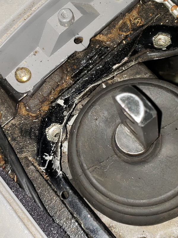

That looks like the trans in in the same location as mine is now. How tall are ya, and how far back does the triax bring the knob? Even without airbags I tend to have my seat as far back as I can, but at 5'7" my t-rex arms(as my kids call them) need all the help they can get to reach the shifter. I am looking to get a set of Chuck W motor mounts, but he doesn't make them anymore. If I could shift the engine/trans rearward 1/2" that would reduce, if not eliminate cutting the floor pan. I can get my DP out in about 5 mins, so filling the trans from the stock fill hole on the side won't be an issue.

FYI my XR has a 02-07-1986 build date, and the crossmember for the trans mount is 12.75" wide overall, not between centers of the slots.

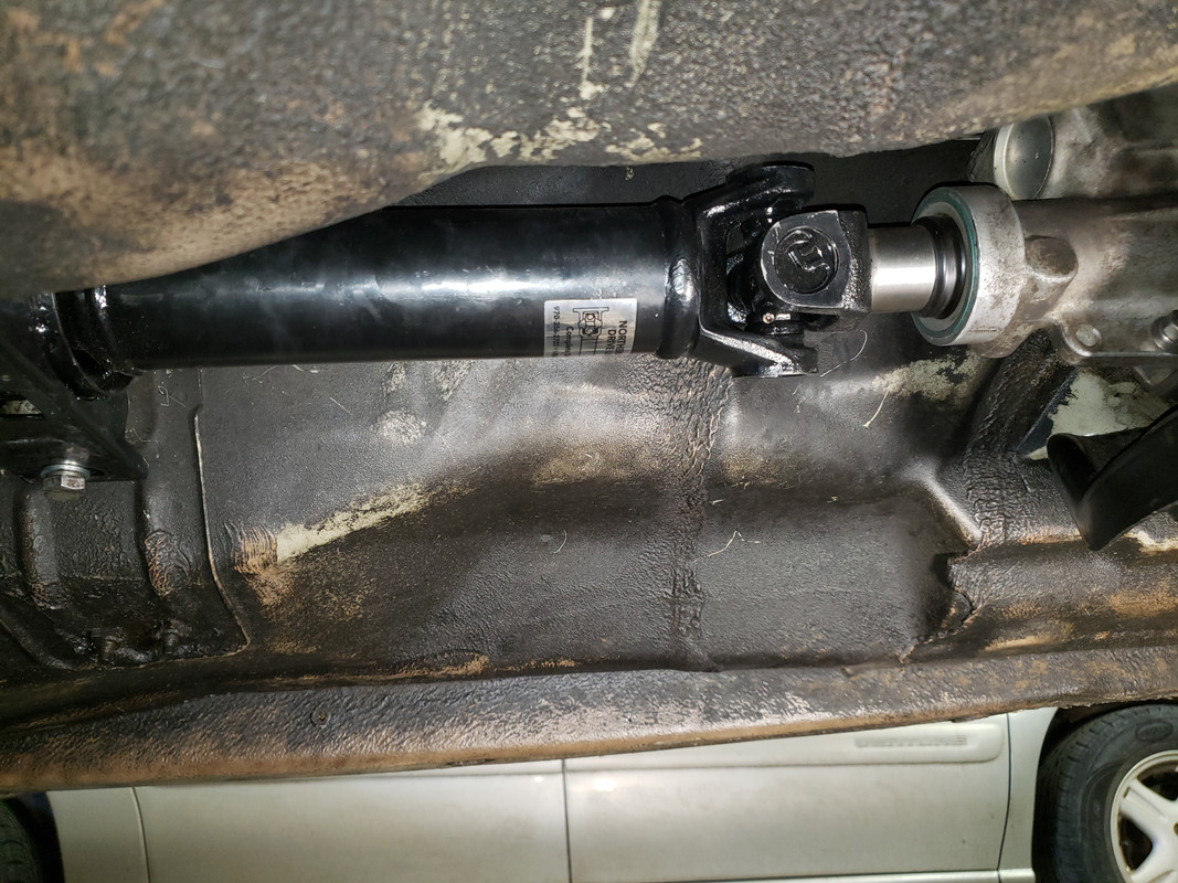

Did a little bit of final fitting of the t-5 today. I think I have a reasonable angle on the front section of the drive shaft, and had to "massage" the tunnel sheet metal with a vise grips, and screw driver to get the inner boot to clear, and not have the trans rubbing on the tunnel once it was shimmed where I liked the angle of the front driveshaft.
Next weekend(provided I don't get a shelter in place order here in CO this week for that damned virus, if I do I'll poke at it everyday I'm home from work) I will be replacing the heater box while the interior is apart(the arm for the vent/defrost/floor door broke years ago when replacing the heater core). Then button up the t-5 install. I got a euro surround from Herson, and skull shifter knob from Amazon. Just waiting on a leather shift boot(also from Herson). I'll worry about sound deadener laterer. Of course once I do get the car running and ready for smog I'll be dead in the water until this virus thing settles down. DMV is closed for in person appointments right now, and they aren't likely to renew the tag for this online as I've failed the most recent smog attempt, and I'm way past one month over due on the tags :roll:
