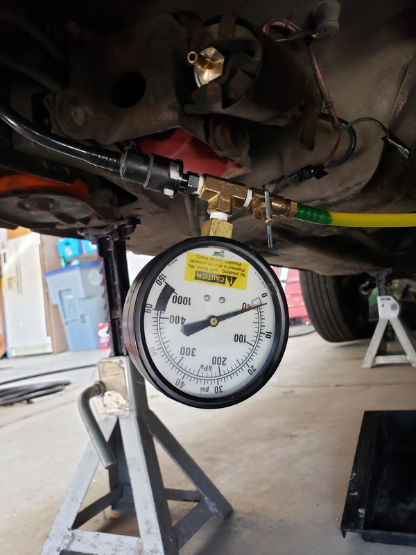

Continuing to diagnose code 42, and overall poor idle, today's results so far:
OTC fuel pressure gauge installed, jumpered relay terminals 87 and 86 at fuse panel socket to rule out bad contacts at relay, or weak relay. 39 to 40 psi at rail in under 2 seconds at KOEO. KOER idles a little better than last week, and I detect a miss still(this seems like this engine has always had a miss, even with new wires etc, and post rebuild way back in 01, have new magnecore wire, and new cap and rotor, and fresh now). Run at 2000-2200 rpm to get hot and miss, or popping(for lack of better term gets worse). 32psi at the rail and about 8-10 in hg vac on boost gauge.
Next fuel volume test KOEO, performed 3x, and also once with external filter bypassed. Less than 4oz everytime. So I either have clogged fuel lines(not likely, none kinked that I can see) or one or both pumps has gone bad.
I see no diagnostics for the individual pumps in the service manual. Does anyone know how much volume the stock low pressure pump should flow to the external high pressure pump?
I'll start taking the tank down and finish inspecting and blowing out all the lines. I assume that when we go to the Walbro high pressure in tank pump we just sub a 2nd fuel filter in place of the external pump? I almost put a Wlabro in back in 2017 when I found the in tank pump bad and didn't do it. Can't remember why, but I think that the Wlabro 255 was scarce, or at least not available from Napa.

Low pressure pump, I made a handy-dandy gauge shut off drain unit for lack of better term:
I had 2psi, and 8oz flow over 10 seconds. I'm guessing that probably low?

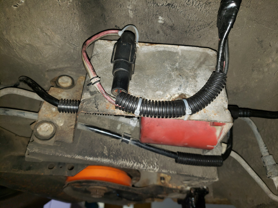

Next, similar different setup for the high pressure pump, even though I had 39-40psi at the rail with this, I still wanted to verify flow with this pump on its own. It flowed 12oz at 80psi(it was powered straight off the battery).
So it looks like the fuel tank comes down next, and I inspect the remaining fuel lines that I can't reach or blowout before I disconnect the remaining fuel pump. I just can't see anything else to do at this point. I really wish the service manual had diagnostics for flow rate of each individual pump, as I really don't wanna replace potentially good parts. I just put the in tank pump in back in 2017... And I'm pretty sure it was for the same reason.
No kinks in any of the fuel lines from rail to high pressure pump. No clog in that line, or the pulse dampener either.
