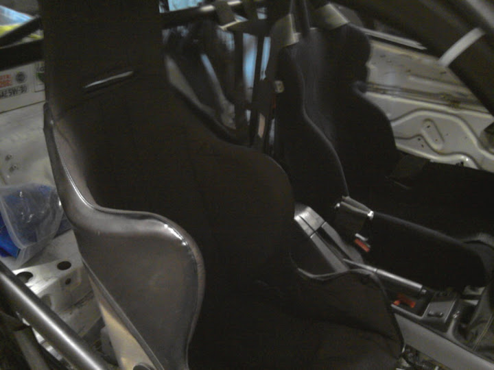

Post by Ray » Sun Apr 10, 2011 7:29 pm
Picked up a kirkey aluminum racing seat (for the pass) and a 5 pt harness for the passenger side. Made me nervous having passengers over there in the stock seat with a regular seat belt.
Hopefully pegasus racing gets me the attachment points by this saturday - will be fabbing the seat mount this week.
It's pretty amazing to me to look at how much progress i've made on this car - not so much in the car itself, but in the learning curve of how to make stuff fit. My old welds make me shudder. Live and learn, right?
-Ray

Post by Ray » Mon Apr 11, 2011 12:54 pm
Am off today so i decided to install it.
Modifying the stock rails to accept a race bucket... Tig welded. Tried acetone for the first time. Works pretty well.
Finished welding...
And installed. Re-dyed the fabric - it was pretty faded.
