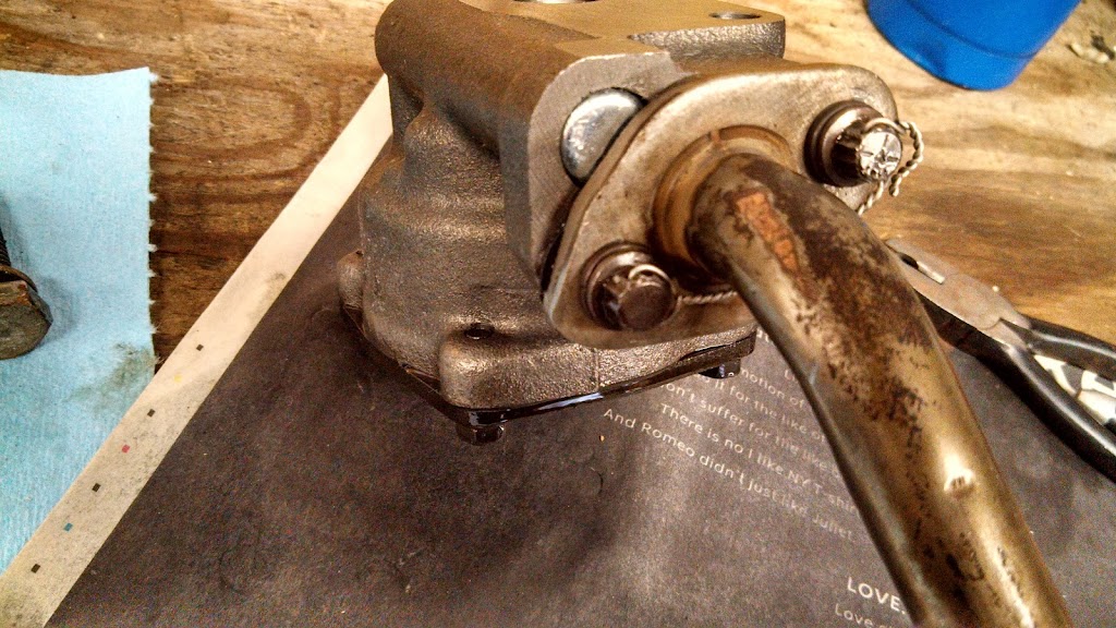

Over the past few weeks i've started my list. Swapped the springs to 600lb/in front back a month or so ago, last weekend dropped the subframe up front, and pulled the oil pan as i had a very slow leak from that gasket since i didn't get the alignment spot on on the rear portion when i put the pan on after welding in the bung for the oil return. I'm glad i did pull the pan as i found this:
Now, i distinctly remember torquing those bolts to spec with my wrench and hearing the click click of the torque wrench when assembling a while back. That's one of those bolts that i really kind of want to stay in place so i pulled the pump, cleaned everything, all the bolts, etc got to soak in mineral spirits over night, were brushed out then brake-cleaned for prep for loctite (used 223 red), but before that i decided a positive lock would be good too, so i did this:
I'll try to get the car buttoned up this weekend, too. It's like 8 degrees right now but i hope spring is coming soon.

Wow. Nice save.
My original motor the oil pump pickup tube cracked at the upper bend. I never figured it out until it was too late. Glad you didnt learn like I had too.
