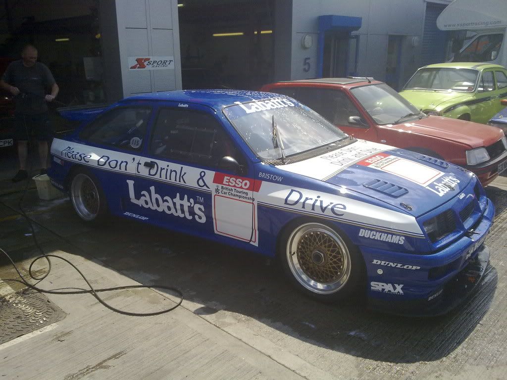

looks awesome, very similar to mine, except my engine is a little less expensive!
my car has already been shown on this thread, its a 4x4 thundersaloon xr4i but with a 2.8 turbo technics v6 instead of a yb (dont have the cash for my favourite engine!!!)
its this one
and randomly i used to live in Denmark too! in Frederiks and Viborg.
anyway, keep up the good work, look forward to seeing this done, whats the colour scheme gonna be?

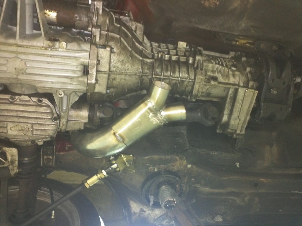

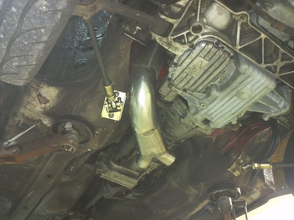

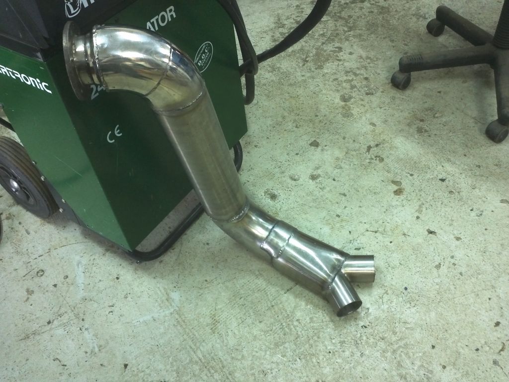

Re: My XR4TI 4WD Thunder Saloon **UPDATE 11-7-2012**
Post by Ray »
Why are you splitting into two pipes again? Looks very nice.
Postal_DK
Posts: 119
Joined: Sat Jul 11, 2009 12:37 pm
Location: Denmark
Post by Postal_DK »
because there is no room for a 4 "exhaust under the car :-)
my XR4TI build thread :-) http://forum.merkurclub.com/forum/viewtopic.php?t=15099

Postal_DK wrote:because there is no room for a 4 "exhaust under the car :-)
Awesome answer! Is it 4" to 3" or something smaller? Very nice job squeezing all that in there.
Ray
Posts: 4332
Joined: Sun Oct 24, 2004 10:40 am
Location: CT, USA
Post by Ray »
Yeah, that answer = good :)
Looks like twin 2.5's? I really am liking this build. a lot.
Postal_DK
Posts: 119
Location: Denmark
Post by Postal_DK »
Thanks :D
Its 4" going in to 2*2.5"
Post by hEaT »
Nice!
The only thing that worries me about the setup is the 2.5" being a bottle neck to the beast of a downpipe.
Just taking the 2D area of the 4" pipe, you get 12.56 sq in. With a 2.5" pipe, you get 4.9 * 2 = 9.8 in sq.
