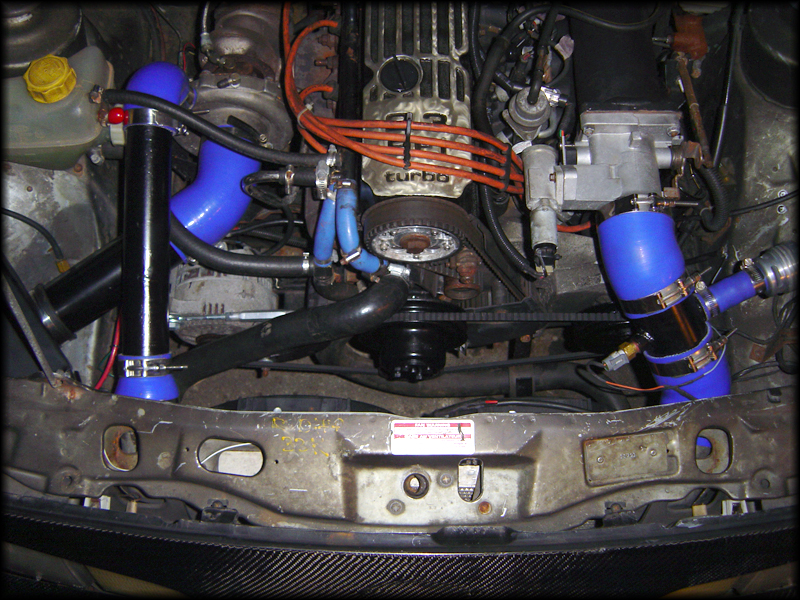

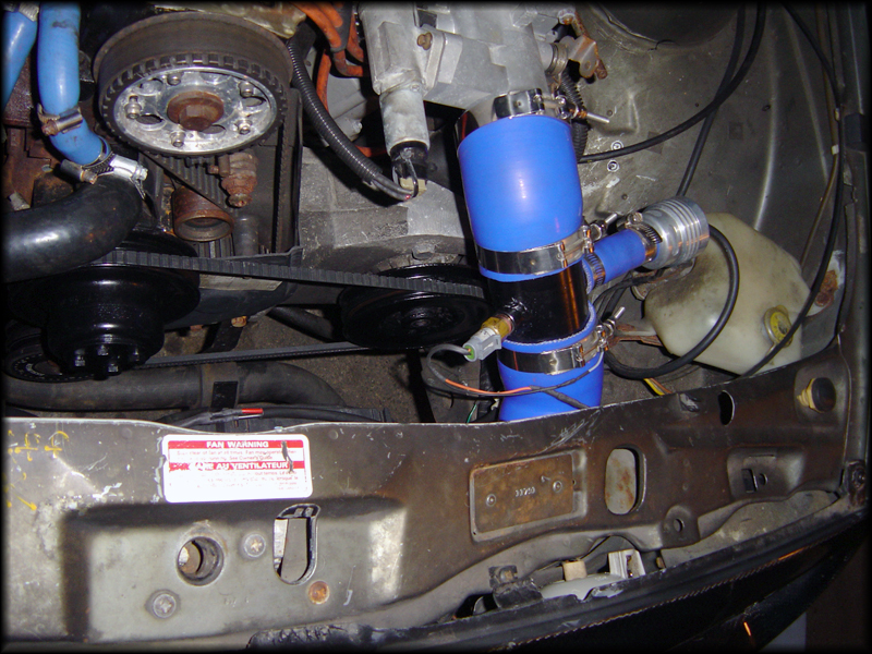

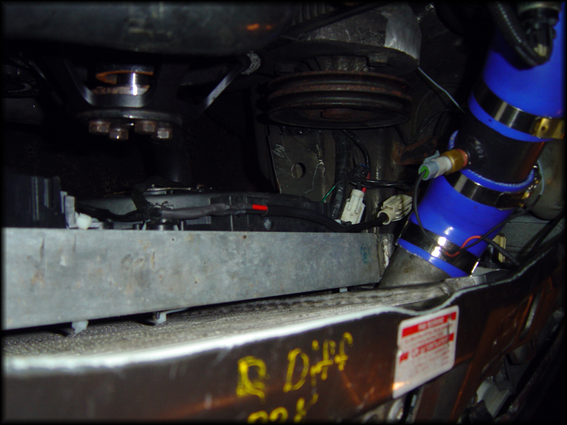

3 weeks of updates (started 3 weeks ago, only a couple days of actual work though).

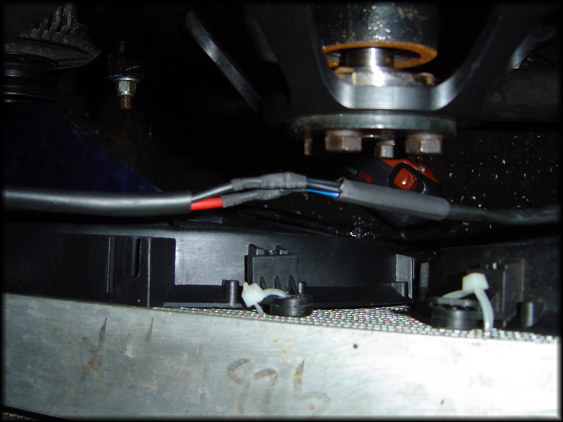

Still was fighting that bull**** overheating issue which led to buying a 2nd fan from Silicone Intakes and wiring that in parallel with the other fan already in the car. Both fans use the stock plug for easy removal:
Tried to loom it nicely:
I think I have some split loom laying around that I can clean it up with.

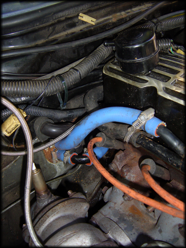

Also removed the hard line that went to the HCV which I deleted long ago. It seems I was getting a steam pocket here since the line was higher than the overflow.

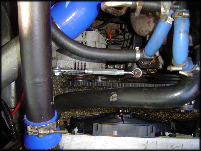

Also, swapped the tensioner for my alternator from the fender to the bracket like Ray had done. I noticed some stress fractures around the bolt in the fender and this is a bit cleaner. Should have done it this way from the start:

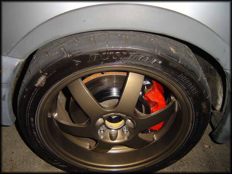

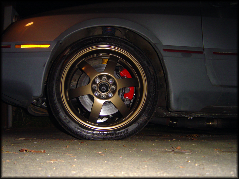

So, in prep for the show part gave the car a full wash/clay/wax and interior detail which I haven't done all year. Also, freshened up the calipers since the paint was pretty faded and chipped in some spots. Also, painted the rotor hats since they seem to rust WAY too easy. Not sure what brand they are. All I know is they are 300mm SVTF rotors.
The bit of overspray on the pad is from some touchup done after I had everything buttoned up and chipped it putting the wheel on. Should wipe off since the pads have a good layer of brake grease on them.

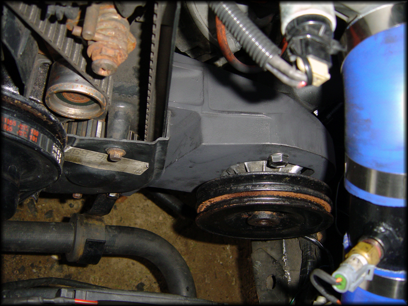

Also put the stock water pump pulley on and cleaned that up. The large Esslinger pulley just underdrives the pump too much to keep temps in check at idle. I may look into a Flowkooler pump and then swap back to this pulley, but not really worth it for the bling factor. Car doesn't need the extra 2-3hp. Also cleaned up the power steering pulley and re-painted the charge piping and filter heatshield:

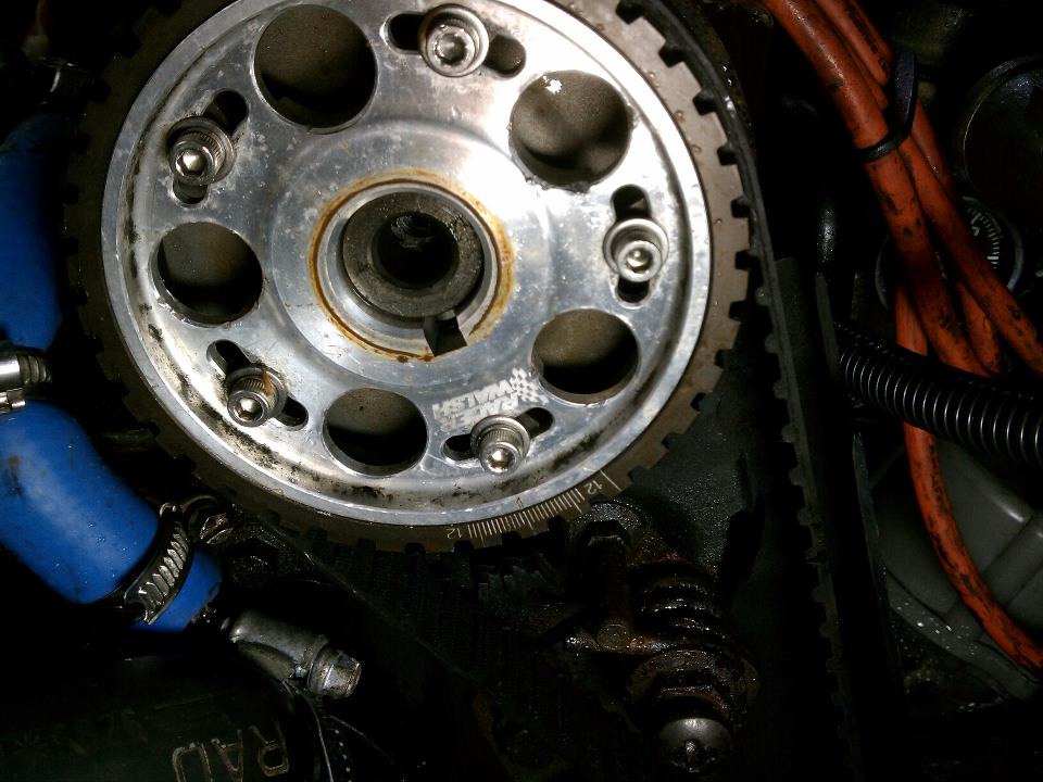

Timing had jumped previously....re-timed and good compression. Car fired just breathing on the key. Crank is in time in this picture. Mark to the right of the 12* retard SHOULD be in the center of the 3 inner cover marks...

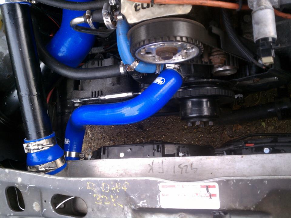

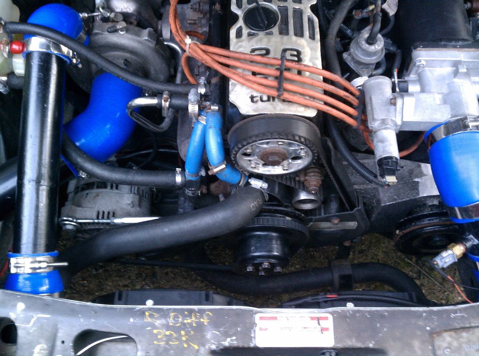

Figured out the overheating. Belt wasn't getting enough bite on the Essy crank pulley with the alt relocate. Bypassed power steering and tripled the bite on the crank and water pump. No more over heating driving maybe 20-30 miles, temp gauge doing the normal thing and STRONG burn your ass out of the car heat.

Samco upper hose in from Mike:

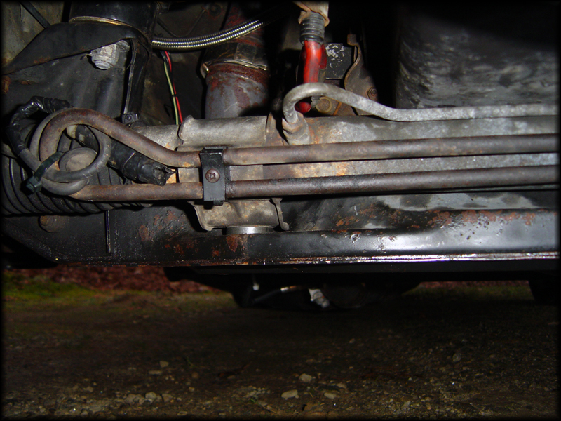

P/S bracket cleaned up and painted as well as the hardware. Replaced the soft return line from the cooler loop to the pump as well.
Since the pump and lines were out, thought it was a good time to replace the rack bushings as well with some nylon units from mc2racing.
OEM came out VERY easily with a 2-jaw puller and install wasn't too bad. A c-clamp would have made it cake, but had to make do with the puller again.
Because of the tiny Essy crank pulley, 3g alt and a single belt, running the belt around all 4 causes it it to slip on the crank and lose cooling and the alt. Plan is to use a spare Focus idler I have and run a second belt around the crank, water pump and power steering and create a tensioning bracket against the back of the belt with the idler.

How does it feel driving without power steering? I've always hated power steering and have contemplated removing it entirely. Creating some sort of loop system between the two sides of the rack.
Was there ever a manual rack made for the XR or any cars like it?
88 5-speed, Red XR
86 5-speed, 4x2 Toyota Pickup 22R
75 F-250, 4x2 w/390
2010 Impreza (wifes car)
hEaT
Posts: 3880
Joined: Mon May 07, 2007 10:12 pm
Location: USA
Re: My Build Thread: Project "Rain Cloud"
Post by hEaT »
It's awful. Once moving it's ok, but I cannot autox with the current setup. If I pulled the rack apart and removed the P/S seals and filled it with grease it would probably be decent. Looping the lines would be marginally better than what I have now.
There was a manual rack for the Sierra which bolts in with the correct extension from the steering column to the rack. Unfortunately, it has something absurd like 4.3 turns to lock. The current rack I have in the car is a TRW 2.5ish turns to lock, not the slower and more common 3.5 to lock so I really don't want to ruin it and replacement ZF quick ratio rack isn't cheap.
I believe the Fieros used a similar rack and they swap in our racks to have power steering. I believe the GT was 3 turns to lock, unsure if it was manual or not. The Mk3 Golfs use a similar rack, but the attachment points look too different to work easily.

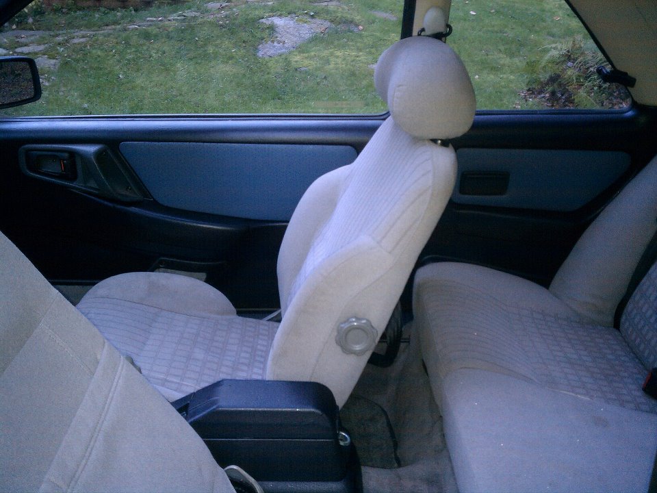

Nice door cards!
The rest of your interior is begging for some updates - i'm thinking black carpet, black seats, blue inserts on the seats (katskinz?) ala focus RS.
-Ray
1985 Ford F150 - Tow Missile
1985 Merkur XR4Ti -#141 CP "Miss Daisy"
2005 Subaru LGT
http://www.cartct.com
hEaT
Posts: 3880
Location: USA
Post by hEaT »
Definitely my plan or all black seats. Maybe a set of reclining Recaro/Corbeau seats.
