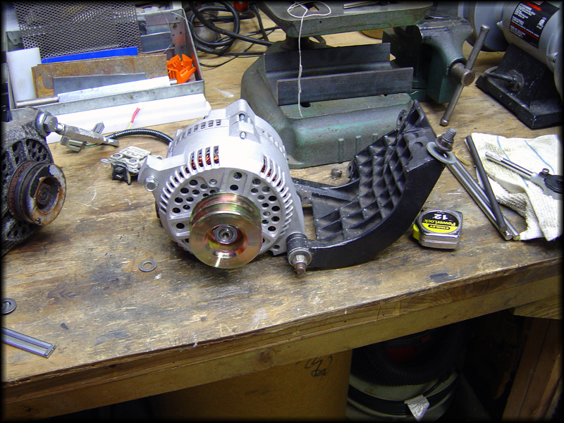

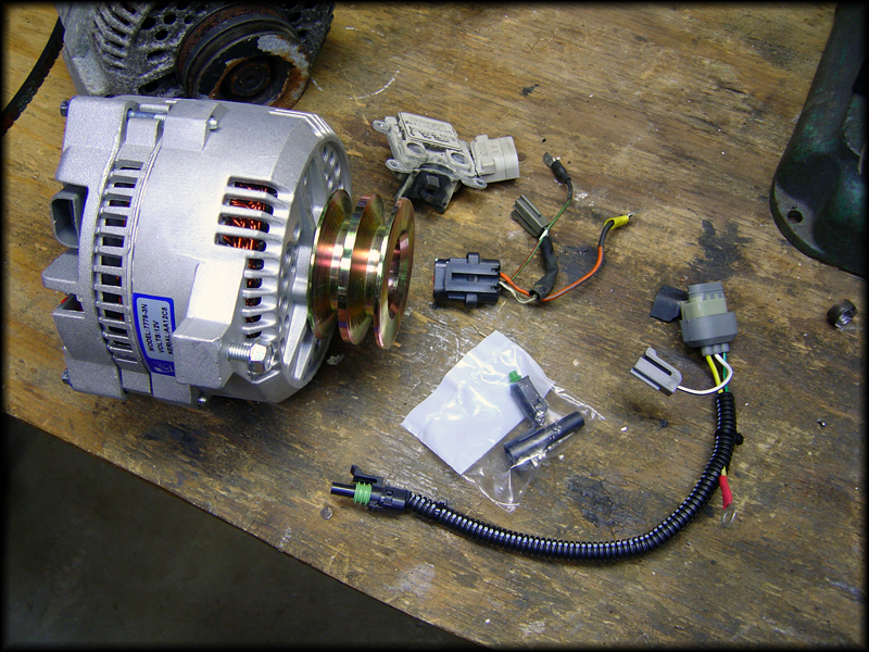

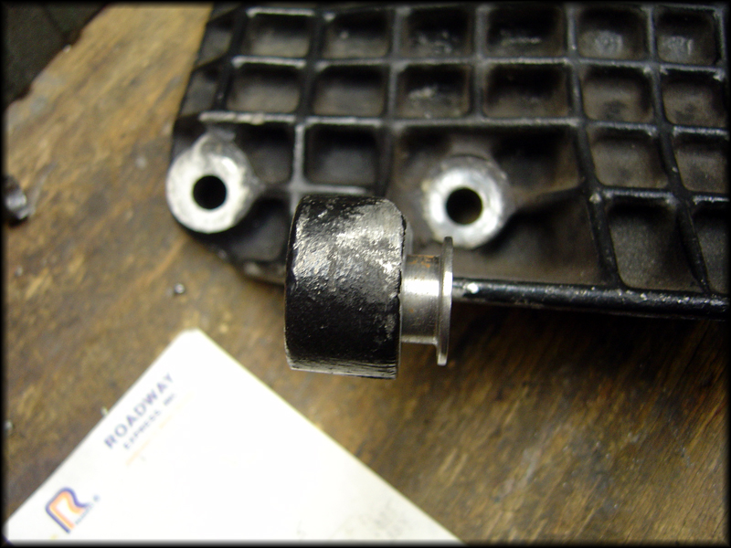

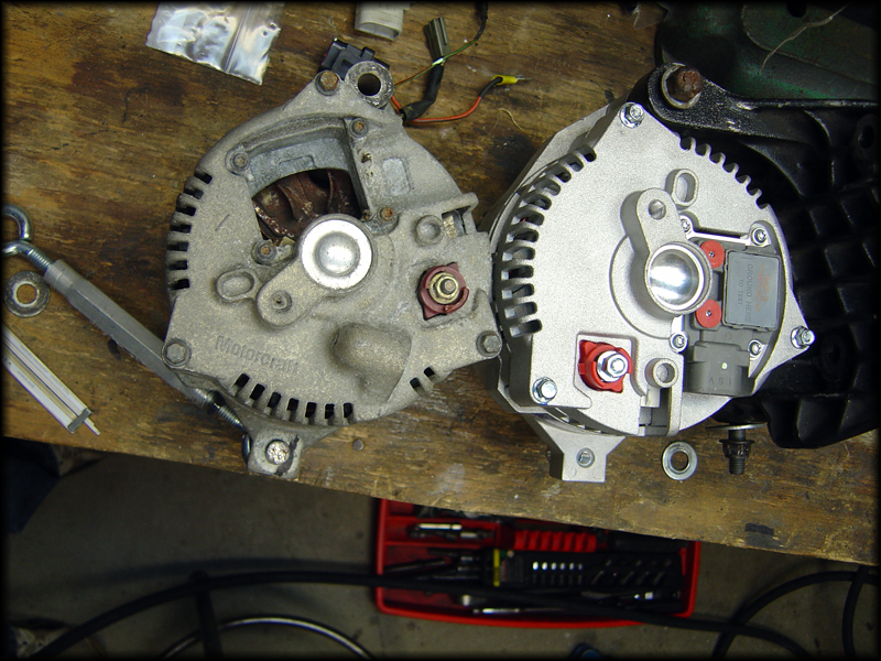

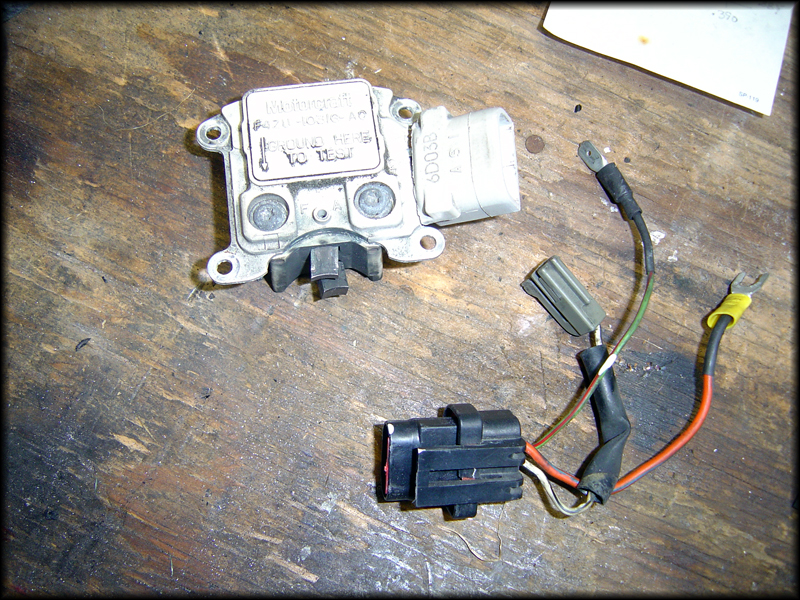

After last event, I ended up with a broken regulator on the alt. Was able to limp the car home thankfully, but needed replacement. Instead of replacing just the regulator, decided to go extreme overkill and pickup an entire new one from RJM Injection. 160amp 3G alt, 7" pivot. Same as the junkyard Taurus unit I had before, but brand new (NOT a reman) and 160amp vs 130amp. At the same time, also picked up a new harness since mine was original from the junkyard Taurus and a new pulley. Was a good move since the bearings in the old one were toast too and had a bit of end play in the shaft.
Broken regulator:
Old alt with the broken pieces:

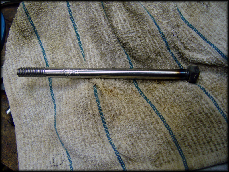

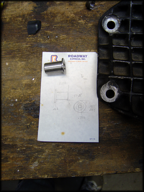

In the process of removing the old alt from the modified AC bracket, the bushing was heavily seized into the ear. Couldn't move it with a mini sledge and didn't want to break the ear off. My father surprised me while I was away by drilling out the old brass bushing and machining a new steel bushing. Much better fit.
Along with the bushing, I made a new pivot bolt to replace the threaded rod I had used previously. Threaded both ends and welded a nut on one side. Other side is topped with a nylock.
New alt with pulley:
Mounted in old bracket:
Unfortunately, the pulley is setup for a different series belt so I had to retain use of the stock one. Cleaned it up with a wire wheel and shot with paint. Had to space it off the front cover as I did with the Taurus piece and reset belt dept in car; .450" off the front of the bracket pivot and rear .200" to allow the bushing enough travel to clamp.
Also, when I ordered the alt I had it clocked at the 12 o'clock position which puts the harness right on top for easy access and better run to the charging post. Comparison to the old:

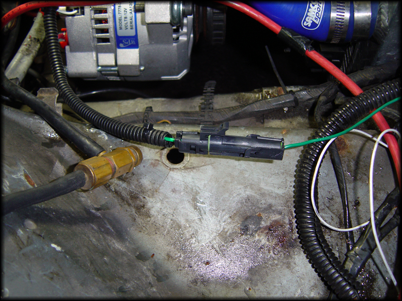

Also came with a new Weatherpack connector for the charging light. Much better than the spade connector I was using previously. These are a breeze to crimp/solder and put together as well:
In car and running. For my tensioner setup, I tossed the bolt that came with the alt since it had no printed hardness rating. Hole is M8x1.25 which I replaced with a spare grade 12.9 allen I had. Looks better and I'm not worried about losing the bolt under tension.
Volts at cold idle (1100rpm). This is with rear defrost, HVAC, headlights, fogs and dual slim fans running.
At hot idle (750rpm) the voltage with all accessories on is around 12.2v. Blipping the throttle hits 15v then settles mid 14s again. VERY impressed and next setup will be a proper battery relocate and getting rid of the hack wiring. This is with the Essy UDP as well which really affects alt RPMs. With the factory 90amp unit I had to rev to 2k before it would even start charging.

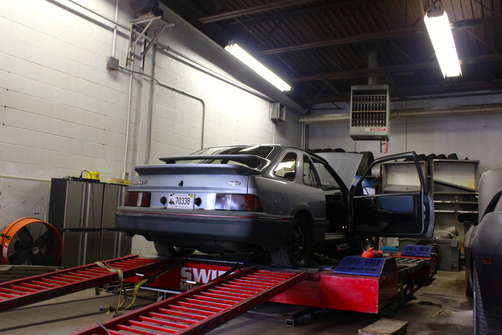

Also made it to the dyno with a few friends for S&G's. My car ended up with the same numbers as last time (245whp) with an intercooler and intake manifold change, but this time didn't have the ~20% correction up factor. Last time the numbers were corrected to match a DynoJet (run on a DynoDynamics). Overall, I was happy. The power curve is much smoother and flatter, doesn't drop off like it used it so I couldn't care less about the actual numbers. The intake manifold made a nice different in power delivery. IATs were 15* or so above ambient with only the dyno fan so the new intercooler is working well too.
Highlight of my day :lol:

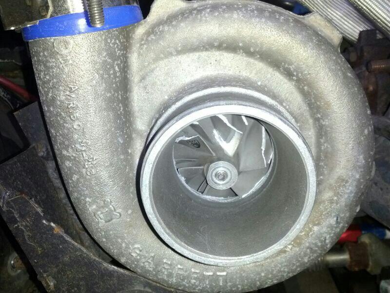

This is what happens at full boost and the nut comes off:
Exhaust side is still good thankfully. No wheel contact and shaft still in the center section spins ok.

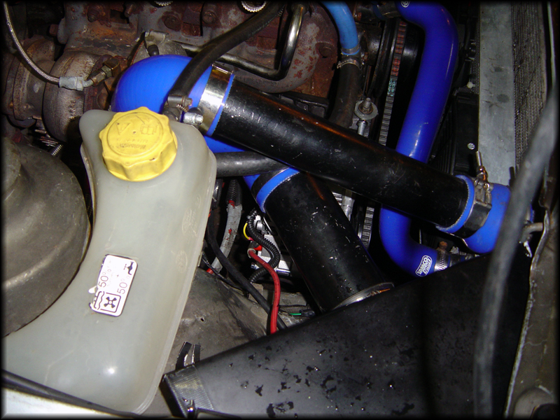

Post by hEaT » Sun May 05, 2013 9:58 pm
Some progress, but I am BEAT. Wow.
Adapter to mount the turbo. Don't comment on my welds please:
Turbo mounted:
Playing with the downpipe, still some work left here before seaming it:
Whole package, but still need some tweaking on the downpipe. Can see where old meets new.
Adapter bolts to the T4 manifold and adapts down to the T25 flange. Vband connects between the two for a modular setup (pipe is sunk through the flange to help seal). Adapter is seamed and good to go, downpipe is tacked and still needs some work. Still have a lot of work left for the coolant bottle fab, inlet, hot side pipe, oil feed, coolant drain, fuel, etc.
