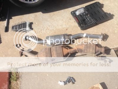

Finally replaced the catalytic converter today. Signs that it was time to replace include: rattle in the converter, general feeling of pulling a boat most of the time, and after a 60 mile trip the other day I smelled sulfur from the converter. The replacement I got weighs about 1/2 as much as the original. It has only one converter in the assembly whereas the old one has two converters. I attached a picture for comparison. I took it out for a test drive afterwards and the driveability has greatly improved. :cheers

It has been a month since I installed the new catalytic converter. A few observations:
1) With only the one converter in the pipe the exhaust note has increased noticeably. (It's okay, just a little loud in a bank drive thru)
2) Engine performance has increased noticeably. Acceleration is better and gas mileage has ticked up 1-2 mpg.
3) No more mysterious rattle noises coming from underneath the car.
All in all, I would call it a success :)
