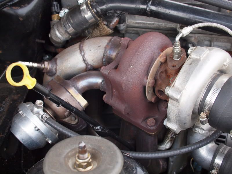

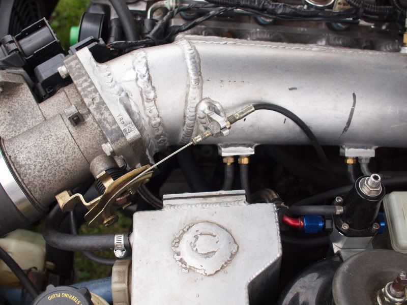

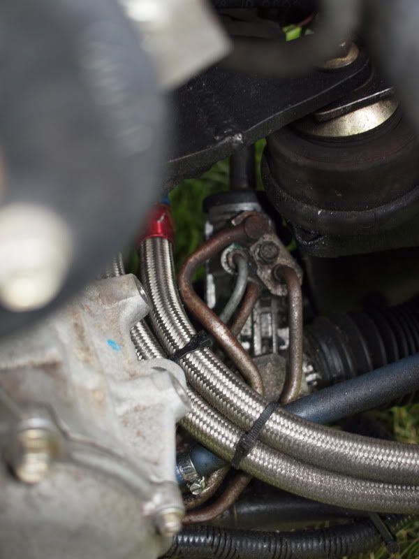

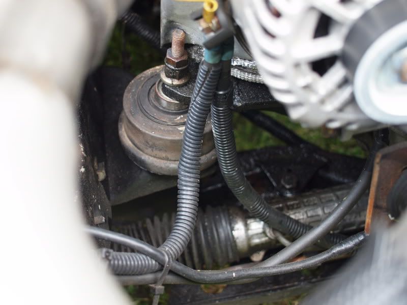

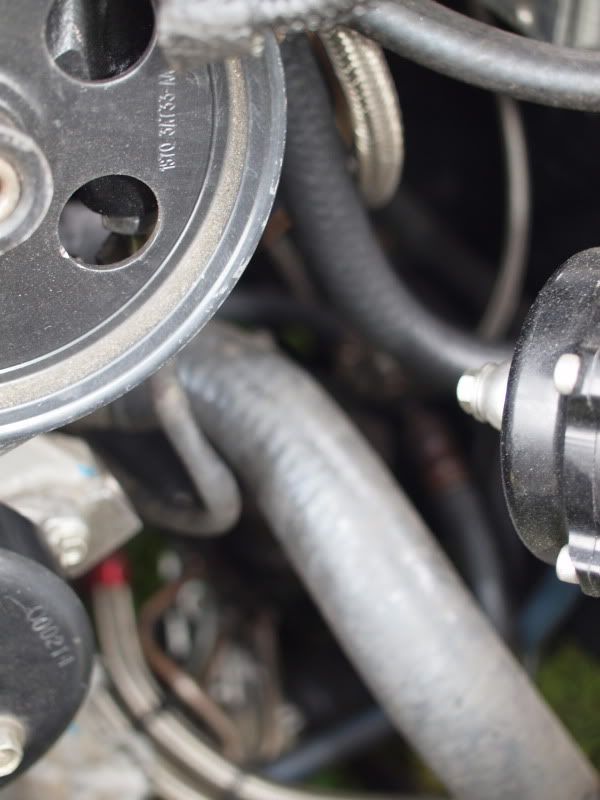

Thanks for the pics Brad!
It's a shame the Cossie IM dumps right into the firewall. Looks like it would work great otherwise.
Ray
Posts: 4338
Joined: Sun Oct 24, 2004 10:40 am
Location: CT, USA
Re: First Duratec 2.3T in a Merkur
Post by Ray »
Thanks for the pics!

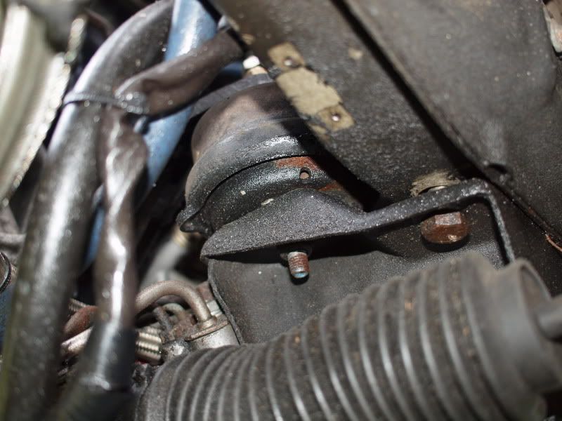

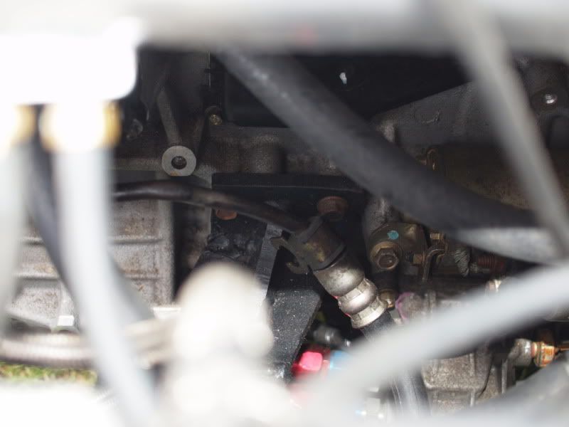

Couple questions - does the coolant degas tank have a cap? is the bolt from the cross member to the frame rail loose?
Posts: 15196
Post by DPDISXR4Ti »
Ray wrote:Couple questions - does the coolant degas tank have a cap? is the bolt from the cross member to the frame rail loose?
Looking over my pics, I actually had the same two questions Ray! I'm going to let Phil's son know, since he's the one who is driving it.

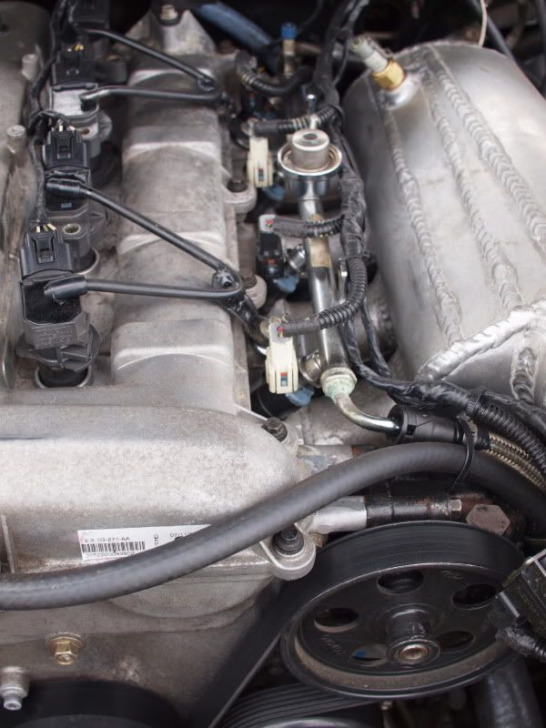

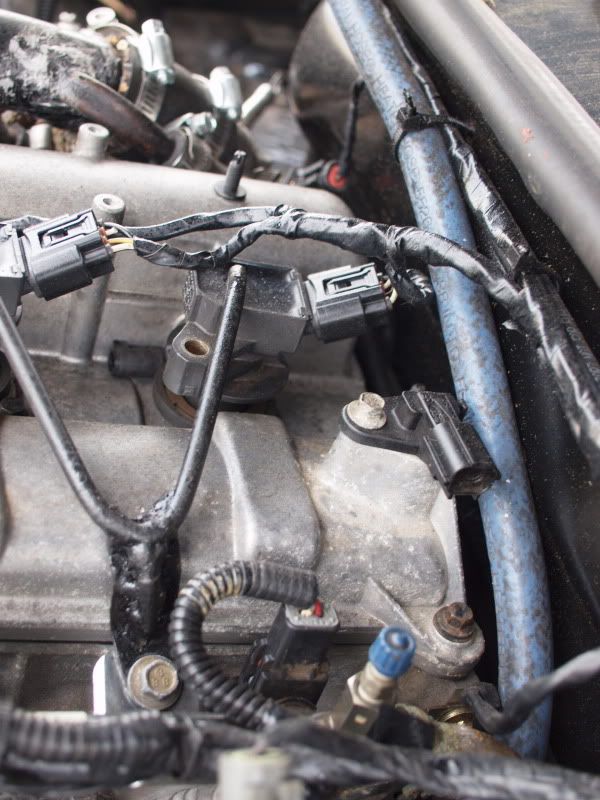

Personally if I had wanted COP, I would have just used the Focus vc and it's coil packs. But that works.
Is this running the QFR bellhousing/t-5? If so, hydro or cable?
I could fill the page with more inquiries....
Posts: 15196
kstylez wrote:Personally if I had wanted COP, I would have just used the Focus vc and it's coil packs. But that works.

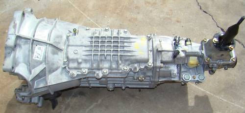

They're Toyota COPs - Phil said he preferred those over the Focus stuff.
Yes, it's the QFR bell, which is hydraulic. I'm pretty sure it was the most expensive part of the whole conversion. I sorta expected to find that Phil had fabricated some sort of hybrid bell, but that wasn't the case. I know I'd look at using the 6-speed from the 2006+ MX-5, but searching now for a pic, it looks like the shifter may be too far back- here's an ebay auction for one for $1650.
http://cgi.ebay.com/ebaymotors/MAZDA-MI ... ccessories

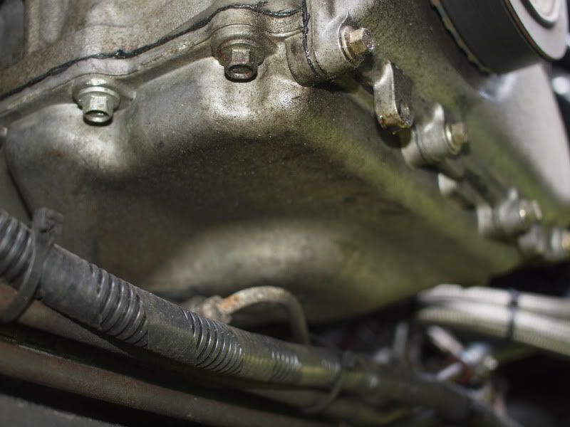

Answering some of your other questions before you ask them.... The short block is from a DI Turbo CX-7. I think the head is from a Ranger. The pan required some re-work - I was trying to capture some of that but you don't see it in the pic.

Interesting. I wrote off the miata trans thinking it would be too weak coupled with the fact i've got like 4 t-5s here... But that 6 speed does look nice. And for that matter the miata 5 speeds are dirt cheap. Found em for $500. That QFR bell retails for more than that. And really, that trans LOOKS long because the bellhousing it built in, but an assembled t-5/bell looks damn similiar in length.
vs
Could be a possibility
