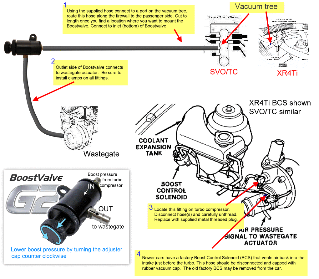

Post by merkurdriver » Wed Sep 12, 2018 1:30 am
Awesome to hear the car finally hit the track :headbang
AND did 100 laps / 250 RACE MILES with no issues? :cheers
10 psi is not much boost at all and I can see why the car was the slowest. 15 psi is stock boost level for the XR4Ti, I can understand not wanting to crank the boost through the roof, but at least turn it up to stock levels.
How are you regulating boost to 10 psi? Mechanically by the wastegate? (Just one hose from the turbo to the wastegate?)
Since you're running an intercooler then gillis valve is a must and works best hooked up exactly like the diagram below.
Do this and set to 15 psi and you will be amazed at the difference in HP/TQ/spool up time.

Post by Dangie » Wed Sep 12, 2018 10:33 am
Mike, yeah we ran a Gillis valve that we happily purchased from you and it worked perfectly. Since we knew this was our first race and there was no way we would have the car even remotely sorted, we turned down the boost to make sure everyone got some seat time. We didn't want to blow a head gasket in the first half hour and then spend the remainder of Saturday installing a new one. So do you think the engine would live for an 8 hour race at 15 psi? If so, we'll give it a try next time. Best lap we could muster around BIR was a 2:09 with me at the wheel. By comparison, a very well sorted, well driven Miata built to the full extent of the rules was in our class, GP3, and put down a 1:48. I'm sure we could get below 2 minutes had we been able to keep the RR down on the ground but 1:48 is a pipe dream.

Post by merkurdriver » Wed Sep 12, 2018 12:21 pm
Maybe come up form 10 psi to 13 psi for the next one and see what you think (temps, etc.) and then after that from 13 psi up to 15 psi ?
15 psi is stock, so its not like you are winding it up to the ragged edge or anything.
