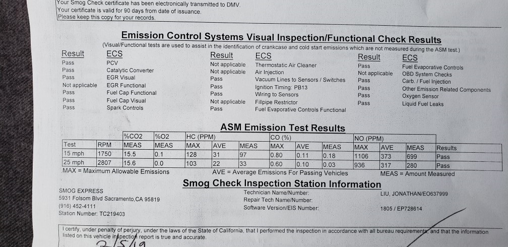

Well, the car passed smog! A wee bit tight, but it's been tight for eight years so I'm not stressing on that.
With this configuration there is a tangible dead spot at 3000rpm with a little throttle. If you've dropped the hammer that moment goes by very quickly, but in normal driving it's annoying. Also, if you get caught in that dead spot during a throttle transition it can be scary. As long as you're going from 2000rpm to 4000rpm it's fine, but you basically cannot be at 3000rpm and 10% throttle or you're stuck. Since it *seems* to be airflow dependent, I'm blaming the VAM.
I'll see what O'Reilly's says, but I am seriously considering leaving it as-is and saving for a couple months for a PIMP. I've got two years from today to get it dialed in!
