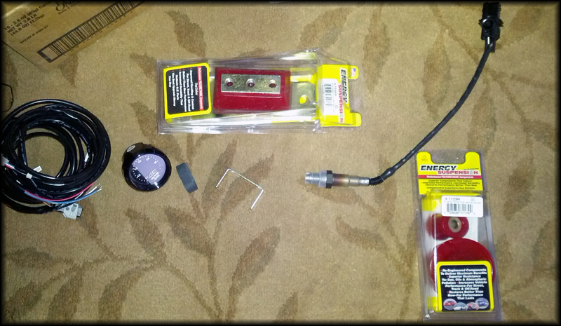

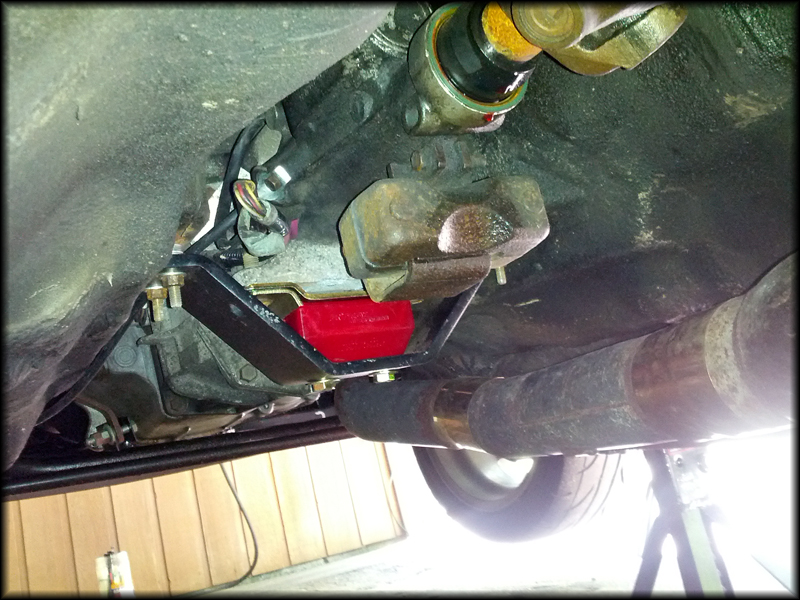

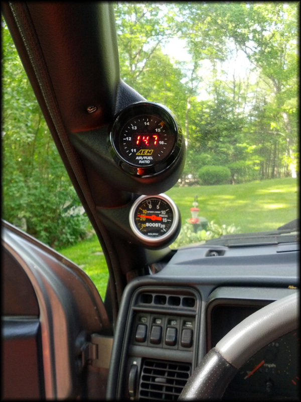

AEM Wideband (DONE with my crap Innovate; hoping the AEM last more than a year ha), ES T5 mount and ES rear motor mount bushings for a Focus (made a mount for friend):
New mount in:
Odd how I still need to space the cross-member down so far to keep the trans from hitting the floor.
Wideband in and working! Still need to some work with the MS. I'm showing a few tenths of a point different between the gauge and TunerStudio. I'm assuming this due to grounding offset and I need to relocate the sensor ground to where the ECU also grounds. Easy enough.

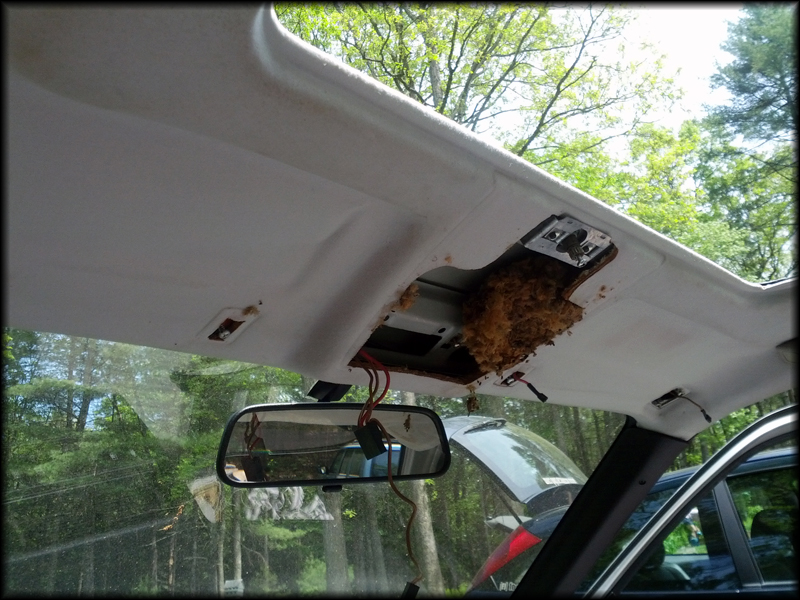

Also began ripping the interior out. The mice did a number on the car this winter and the smell is finally getting to me.

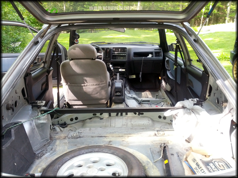

Nest #1:

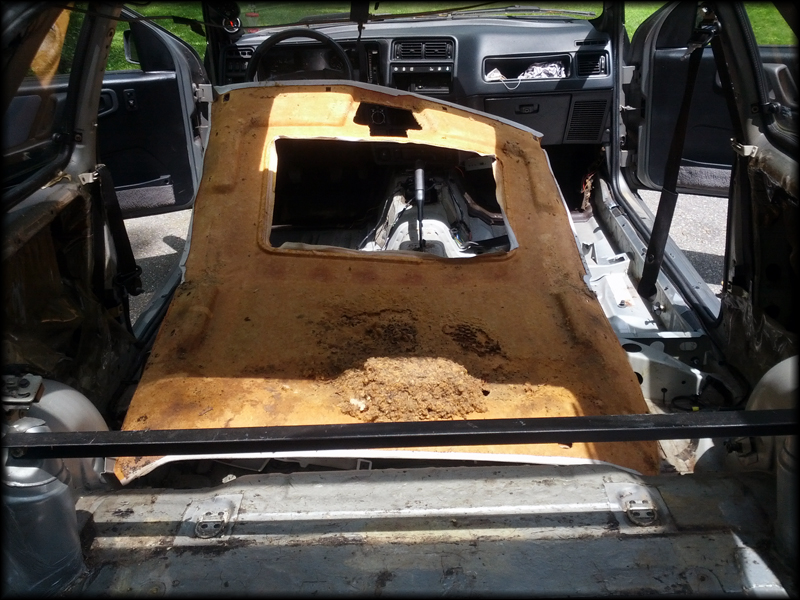

Nest #2 and headliner down. Board has holes in it and is soaked in urine. Definitely need an entire new one

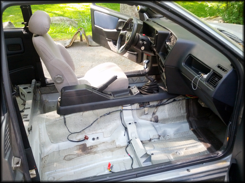

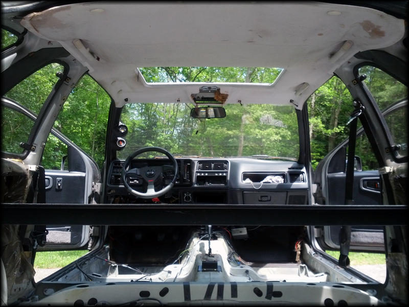

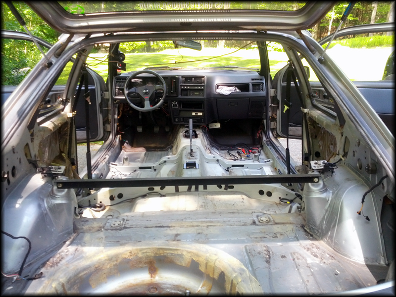

Everything out of the car less the upper/lower dash and pillar trim:
While everything was out, using a bleach and water solution sprayed and wiped down every inch of steel to remove any urine hopefully get rid of the smell. Also chased the threads for the seat mounts and cleaned up the bolts. Re-taped the wiring into the channels on the roof as well as the factory tape being 28 years old wasn't holding anymore.
Back and drivable:

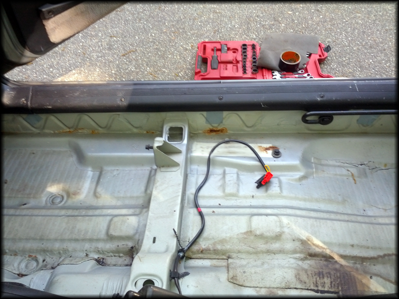

Little bit of rot coming through. While the carpet is out, going to cut this out and put new steel in before it gets worse.
Plan for the interior is to pick up a black carpet, disinfect my interior trim and dye black, get a new headliner board and cover in black suede and get a set of proper seats in the car. Debating between fixed back and a sport seat seeing how much street time the car has.

How much was that tranny mount?
hEaT
Posts: 3902
Joined: Mon May 07, 2007 10:12 pm
Location: USA
Re: My Build Thread: Project "Rain Cloud"
Post by hEaT »
Ray wrote:Yeah, keep your car streetable. I like the progress. If you need help wrapping that 'liner let me know i've got some experience with fabric work from my car audio days.
Definitely will do, thanks Ray. Unfortunately...I don't think the board can be saved. Sourcing a new one is going to be hard just due to size and rarity :( Finding a new one I don't care about the quality of the fabric as long as the board is clean.
Tranny mount I got from here:
http://www.energysuspensionparts.com/pr ... rod=4.1104
After I bought it, I saw a few posts of having them go on people. Maybe hold off and I can see how this one holds up?

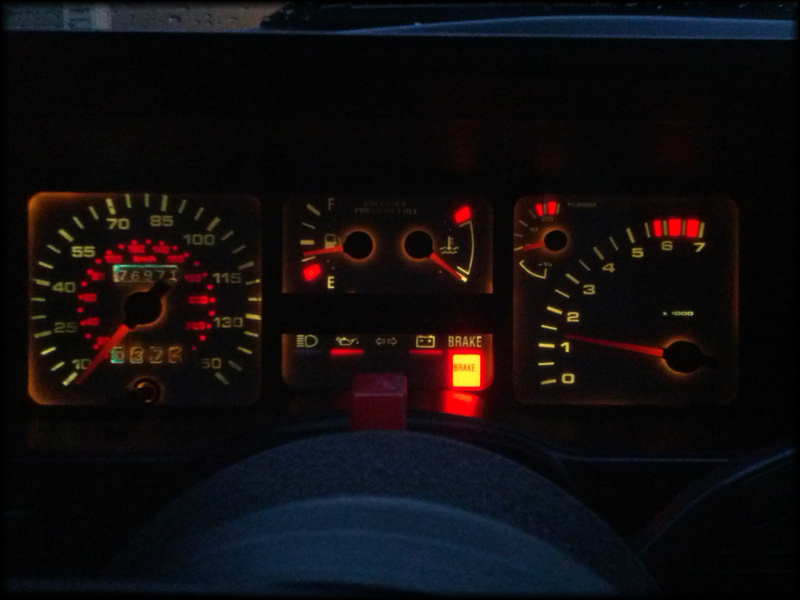

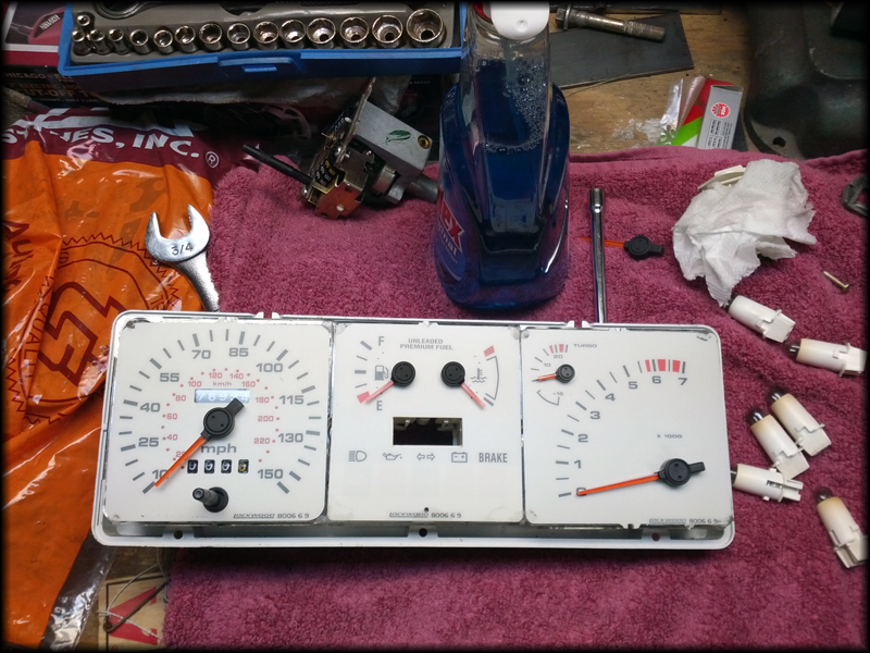

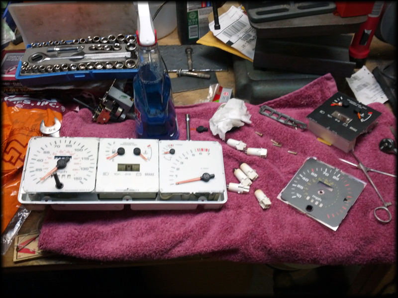

One of the small parts I got was a set of Lockwood gauge faces and cluster. Had good bulbs which I replaced mine with, and also a fixable tachometer. I've re-soldered mine a few times and it still doesn't work. These one barely read anything when in-car, but after re-soldering every joint on the board it works perfect.
Back home, little bit of mixing and matching putting together the best of two clusters. Also swaping over my speedometer guts to keep the mileage.
Done! They were pretty dirty, but cleaned up nicely:

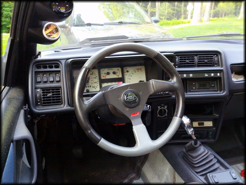

The "cockpit" for now. Interior plans will be addressed later this year or next:
Gauges at night. Still need some tweaking as they aren't 100%. I'll see if I can play with the face positioning to make it look OEM. The camera is picking up a lot of light bleed with the long exposure which isn't as bad in person. Still want to give it a go and see what I can anyways.
