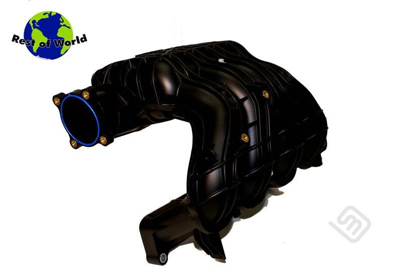

But wait, there's more! Starting in 2013, in Brazil, Mexico, and other places across the world, the Ranger lived on as a RWD small truck, now powered by (among other things), the Duratec 2.5. It's typically called the Duratec 25 there.
Massive Speed imports the factory intake manifold for this engine. Don't get too excited though. Price is $375 and since the TB is located up high directly over the engine, I doubt it fits under our hoods.
https://massivespeedsystem.com/products ... Y4LvuhjLrw
This manifold takes advantage of the larger 2.5 inlet port, and offers a larger plenum and somewhat shorter runner for higher rpm power! Excellent for your RWD swap/ conversion/sand rail/etc!!! Does NOT have problematic tumble flaps found one some 2.3 Ranger manifolds. Designed for a drive by wire throttle body,
