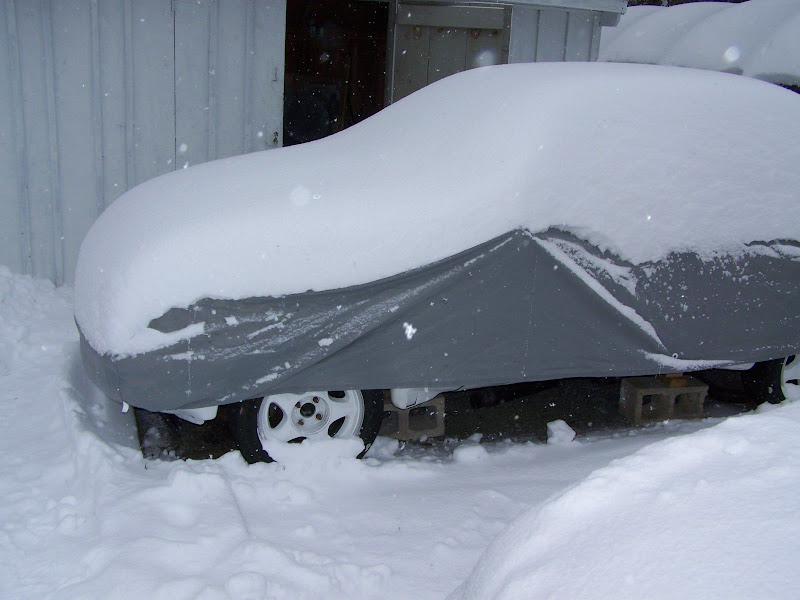

Wow. Snow. Again.

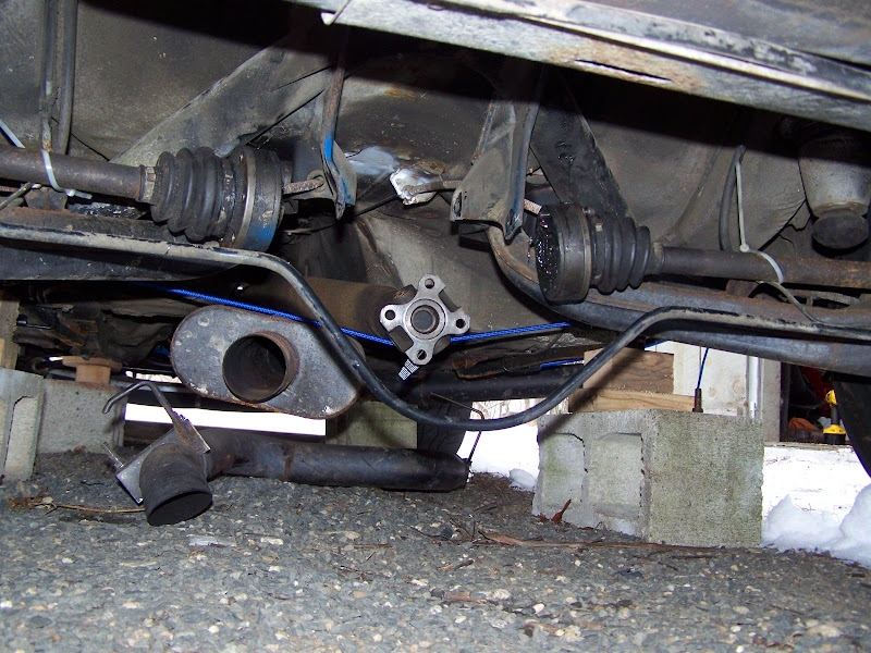

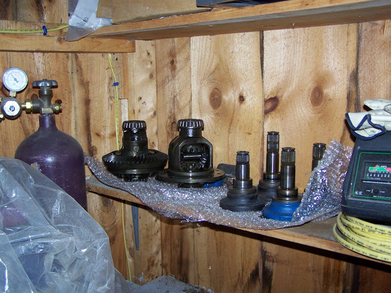

Pumpkin in the shed, view w/o

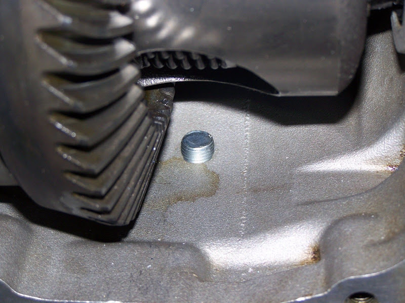

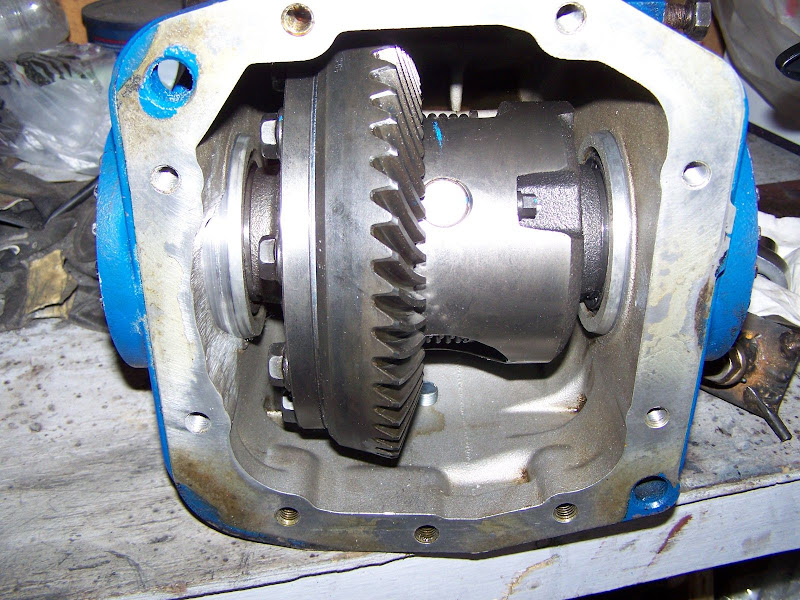

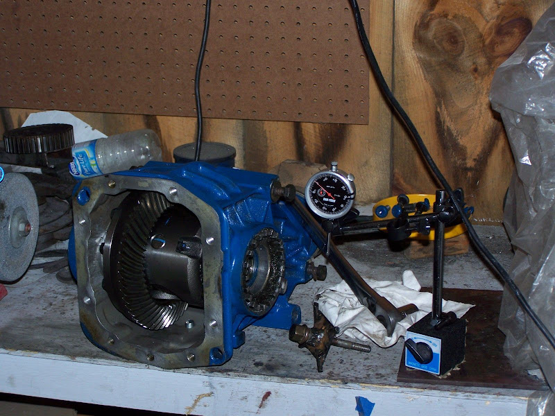

Eaton in, clearanced case, backlash about set (ended up at 0.006")

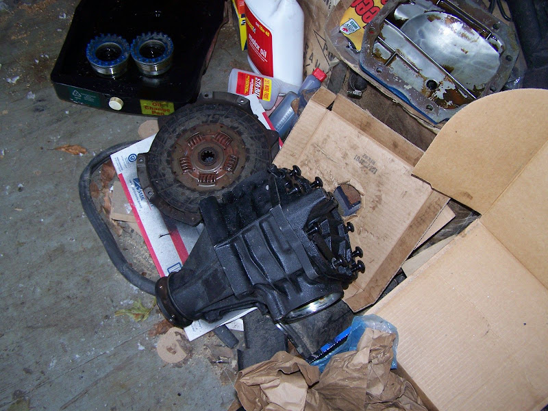

rackin' up the extra / spare parts now. (clutch is from my truck)
in. clearanced case. drain installed. (just to the right of the case is the tool i built for the side adjusters)

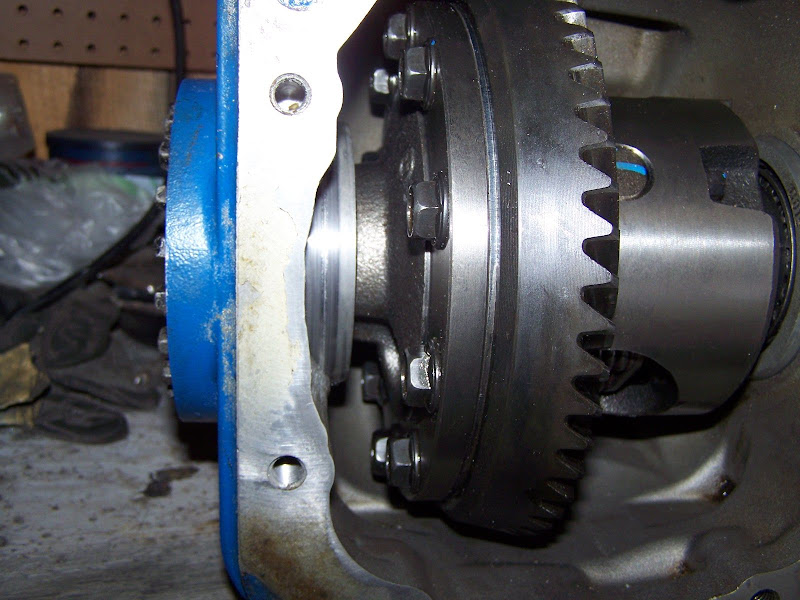

showing what had to be clearanced.
and to add some convienence, a drain plug

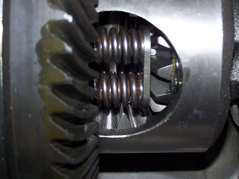

showing the springs and gears in the eaton:
special thanks to mc2racing for providing the rebuild service and pressing on the bearings. thanks to Joe (hEaT) for helping with getting this done.
Next up: rear disc conversion. I would have taken pictures of putting the diff back in, but when you're putting a diff back in a car, by yourself, in the snow, on gravel, taking pictures isn't really a priority. Anyway, it looks exactly the same as before, but with more better guts inside.

The pattern is indeed the same once you're done.
What's more concerning/interesting to me is that the case should be smacked around with a rubber mallet after initially setting the backlash, just in case there is a little bit of binding in the bearings after assembly. The backlash can then be double-checked, and adjusted if necessary. One time when I installed a Quaife diff I set the backlash perfectly, and the axle whined. I pulled it out, did everything the exact same way, and there was no whine. The difference? The bearings probably needed to settle in a way that rotating the ring gear won't fix. You either need to drive it (the slow method), or knock the case around with a mallet (the fast method).

My case was well aquainted with a rubber mallet - it didn't change the backlash for me at all.

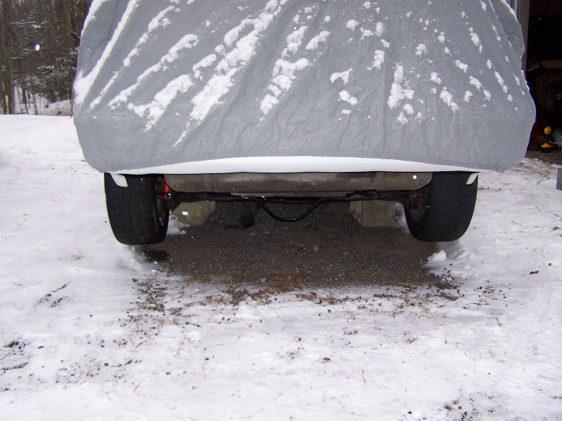

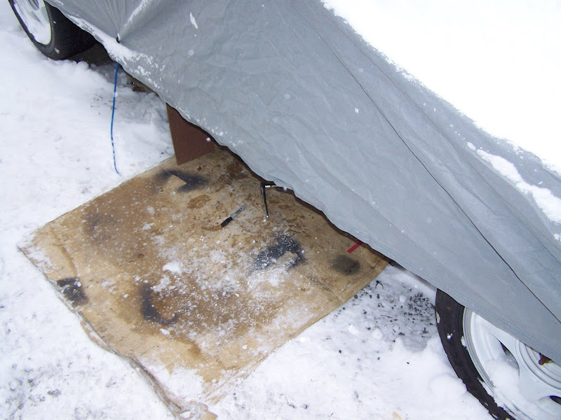

Snow Day!

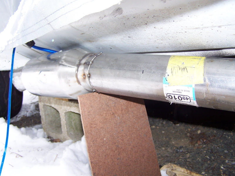

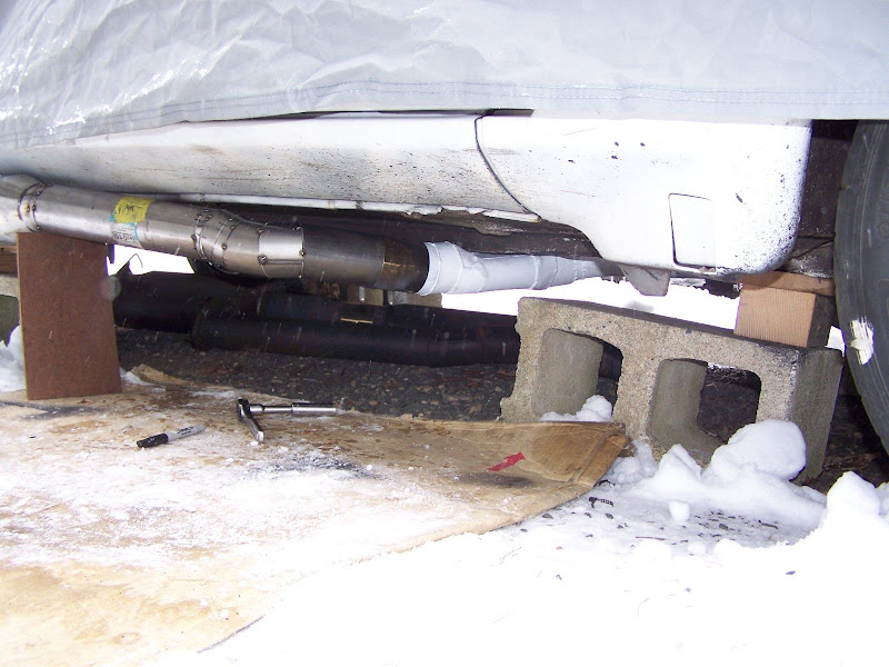

Joe (hEaT) and i started this last night. We ended up realizing that harbor freight chop saws aren't that long lived, as mine lit on fire. After a quick trip to the 'depot, i picked up a 14" abrasive rigid chop saw (lifetime warranty). Cuts were SOOOO much easier and quicker.
Anyway, what did we start working on, you might ask? Well, if you remember my car has that side exit open downpipe. Since i'm a fiend for losing weight, i figured why not just axe the entire exhaust, and make it side exit only? hEaT will be running my old 3" exhaust with the side exit, and i'll be running this conglamation of cuts.
Anyway, if you're not aware, we got some snow (it's still snowing) and since my office is closed i figured i'd work on this project some more.
As always, the "it only snows on work on merkur days" picture
fun working environment. luckily that was only needed for test fit / mark / get the angle / etc. the rest of the work was done in my shed.

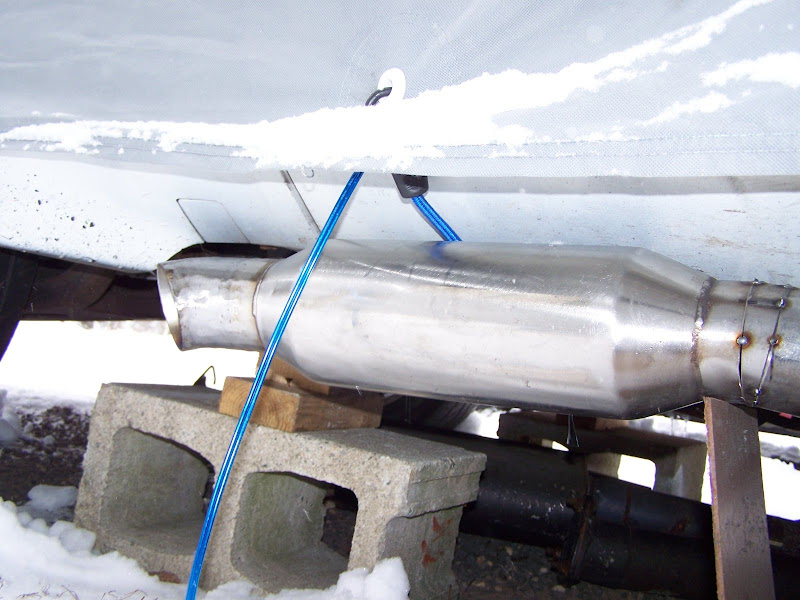

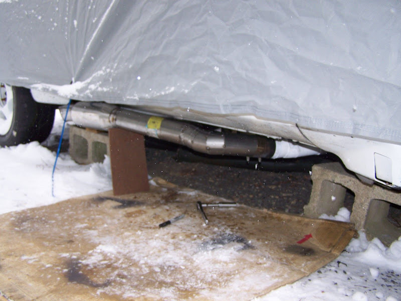

downpipe to a couple 15 degree bends (out, down, up, out) to the oval transition i built to go under the frame rail. 2" tubing split lengthwise with 2" sheet spacing it yields 7.14"^2. 3" tubing has a cross sectional area of 7.08"^2, so it's about right. to blend 3" round to the oval, sheet metal, welder, hammer... and repeat.
Anyway
and slightly out and up, then back to get it level...
you can see how the down turn (again, three cuts with slight angles) is already ground out to be mostly smooth. it's not a show car but i figured i'd spend the extra 45 minutes grinding welds.
slightly blurry, but you get an idea of the amount of work that went into this
less blurry, showing the band clamp (for easy removal), oval, and most of the tubing.
To secure the rear portion of the exhaust i'm going to weld a bolt to the bottom (short bolt), then use some aluminum flat stock bent to go around the pinch and such, which will be secured to the floor pan. I might do this twice.
anyway, i masked off the resonator, precleaned, and painted the tubing flat white with VHT flameproof paint. To get an idea of the color, look at the oval transition.
next up - stainless braided brake lines and rear disc conversion (thanks to mike and ben)
Anyway
